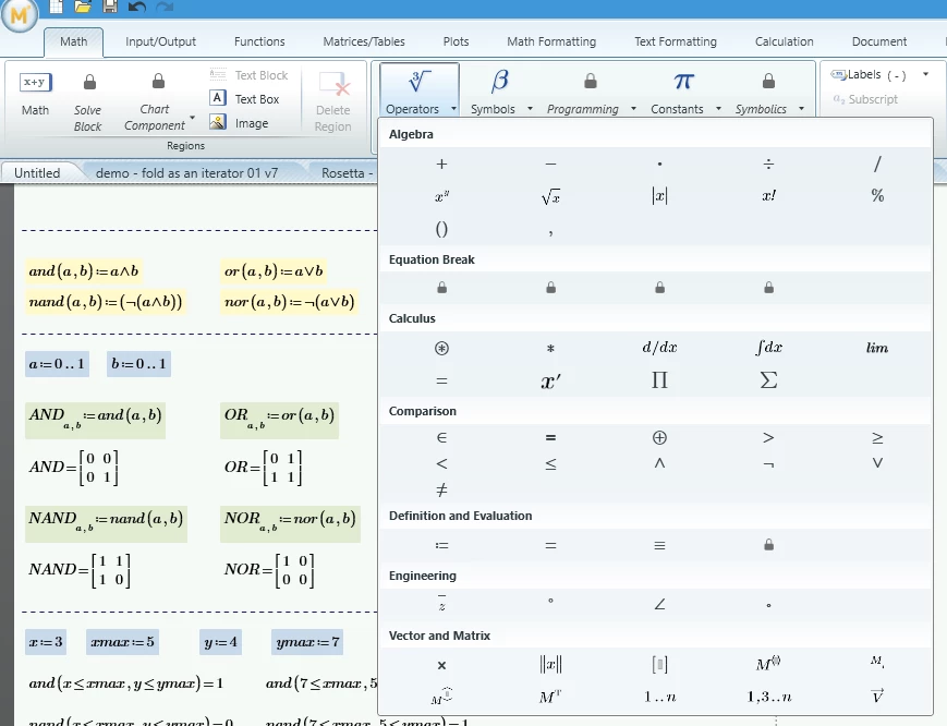

If you don't define and function, and(M, N) is a graphics function. Therefore use "and" operator that I show the second line and the if function operate.
t.t.
ttokoro
ttokoro21-Topaz IAnswer
October 2, 2021
t.t.
October 2, 2021
@ttokoro many thanks, don't fully appreciate what you have explained, but understand it's application 🙂

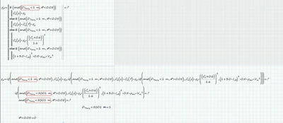

@SA_9950729 wrote:
Having a problem getting the following to work, I think it's really just logic, as trying to use to determine which one equation from 4 should be being used!

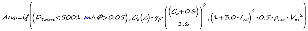

ttokoro's way is the correct way to address the problem; that is, using the boolean operator ∧ from the Math ribbon's Operator tab, in the Comparsion goup.

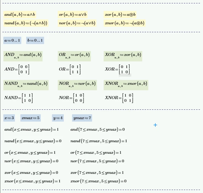

An alternative (having done all the hard work in writing and functions!) and one that I use for other booleans, is to define function's and, or, xor, etc to use as seems fit.

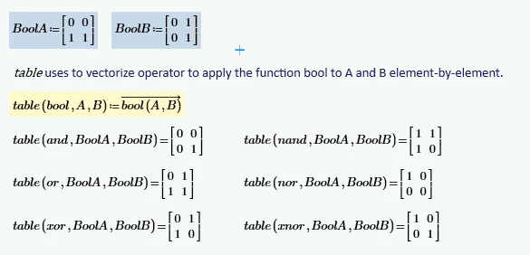

I've often found it necessary, not just convenient, to use these functions when I need to pass one or the other as an argument to a function.
You can't do that with an operator.
The attached worksheet was created in Mathcad Express 7, but the concept should work in almost any version of Mathcad.
