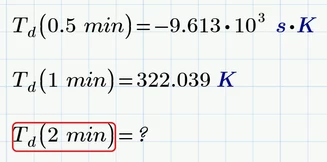

Your function T.d creates a unit mismatch and is incomplete.
For t=1 minute the result is a temperature but for t<1 minute the result is temperature times time and for t>1 minute there is no result defined:
BTW, what you wrote
Td(t) = if(t<theta,To,T*(t-theta)
could be done the very same way in Prime, too. Mathcad and also Prime offer two ways for an if. The if-statement in a program as you had used and the if-function (similar to the if function in a spreadsheet).
To duplicate in your program what the if-function does, you would have to use the "else" statement instead of the second "if". But the unit problem remains.
