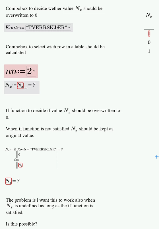

I'm trying to solve an issue where I want the if function to work, when one of the variables in some cases could be undefined.
Is this possible, or have some work around?
I'm using Prime 9.

I don't see a way.
Even the 'Try/On error' programming construct will not allow an undefined variable in the 'try' part.

As already Luc shows, at first fix the error in Prime sheet.
Then you can use your functions.
