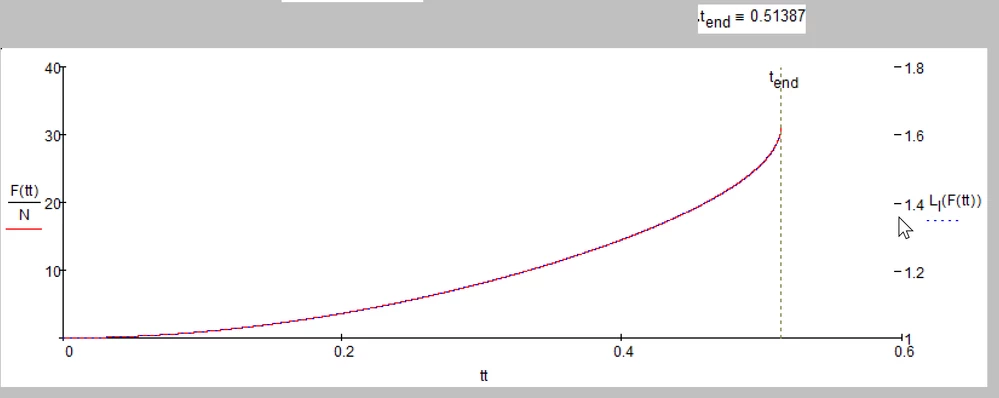

@ValeryOchkov wrote:
Can we use IF in the Given-Odesolve Block?
Yes, we can! 🙂
The problem is not the if-function you used.
The error message says something about an unstable problem resulting in a step size too small and suggests that you reduce the integration interval.
If you follow this suggestion and set t.end to 0.5 the solve block perfectly works.
Looks like the solution curve has a tendency you shoot up vertically at the new end value which makes the solve block fail if t.end is larger:
Thanks, I see
I use not if in attach.
Yes, but thats not equivalent, thats a completely different function .
As already written above, the if function is NOT the problem.
E.g. you may use
with success, but if you use lower values than 66.323N for "limit", the block gets too unstable and fails.
