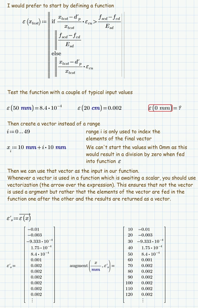

And what kind of data structure do you expect as the output?
You have to be aware that ranges are not vectors! Ranges should only be used on three occasions:
To index the elements of a vector or matrix
In a for-loop inside a program
As abscissa values when you plot a function
In all other cases you should use vectors.
Maybe this is what you are looking for:
Prime 9 file attached
