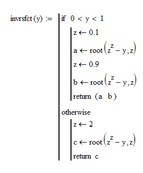

All I want for Christmas is a simple if / otherwise block like this:
But all I'm ever able to get, using from the Boolean toolbar, is something like below. How can I get the structure like in the image above?

All you need for Xmas then is to press a closing square bracket with the cursor at the placeholder before the 'if' or the 'otherwise'.
You can also select 'add line' from the programming pallette.
