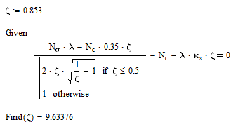

MathCAD newbie here so apologies in advance if this is a dumb question,
Is it possible to have a conditional statement inside a solve block? I have a problem setup that I am trying to solve for a variable. But not sure i set it up correctly.
I have a conditional statement inside the solve block, and getting error
Guidance would be appreciated
23-Emerald I
Convert your if statement to a function and get it out of the solve block.
The problem is not the conditional statement - the error is thrown because you are using an undefined variable xi.
While personally I would prefer Freds solution, here is an alternative approach. You can make xi a searched for variable, too:
As you are not interested in xi you may also finish the solve block with
As already said, I would rather recommend Freds Solution.

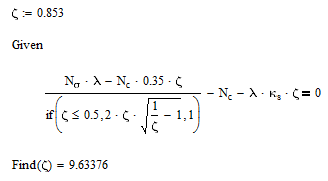

Here an approach without using xi at all, rearranging the equation and using the conditional statement directly in the equation.
or
Nonetheless, I'd still vote for Fred 😉
