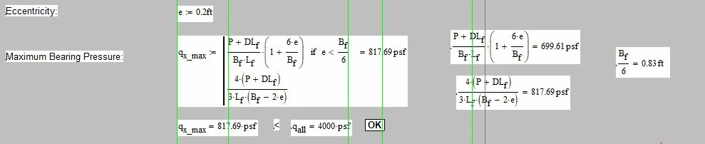

If statement only giving second term's value. Works fine for coworkers!!!!
I am using a simple if statement, regardless of the value of the defining variable it prints out the second term's value. However, if I give the file to a coworker the if statement works correctly.

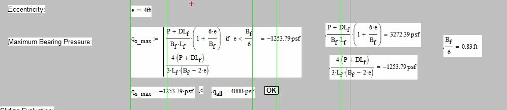

I haven't got Mathcad to hand at the moment, but looking at your images, your "if" statement is incomplete.
If the condition is true, Mathcad will calculate the first expression.  However, it will then go straight on to calculate the next expression because you haven't told it to stop processing and return that value.
You have a couple of options.
1.  Put a return operator in your "if" expression, so that it looks something like "return <expr1> if <cond>".
2.  Put your second expression in an "otherwise" operator, "expr2 otherwise"
