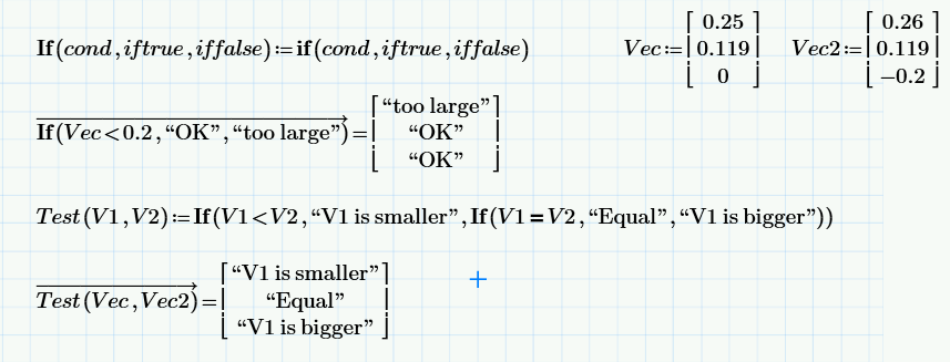

What is the proper way (in Prime 3.1) to create an if statement that compares the values of a vector to a single value? Please see the attached photo for a better description.

Like this?

It depends on what you want as a result:
If you want a vector of 1's and 0's that's the same size as your comparison vector, use the "vectorization" operator.
If you want a single 1 or 0 (e.g. if all values are less than 0.2), use the comparison max(Vua/Vn)<0.2

Thank you Mark, I'm looking for the first result. I tried multiple arrangements of the "vectorize" operator and each resulted in an error. What is the correct way to use the vectorize operator in this situation?
May 11, 2016
Hmm.. it appears the vectorization operator does not seem to work with "if" statements.  We could write a program.  However, if you true and false results are simply 1 and 0, you don't even need the "if" statement:
Mathcad already stores "true" as 1 and "false" as 0.
