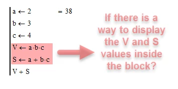

If there is a way to display the values of variables inside a block in mathcad 15?

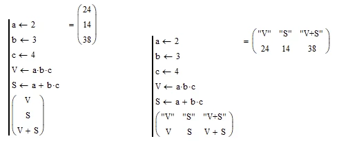

No, there is no way to show these values somewhere inside the program block, but you sure could return them along with the final result

Is it possible to get the same thing using the program trace window?
Sep 7, 2025 1:57 PM UTC
Sure, if you don't want the values to displayed like variables in the Mathcad sheet, using "trace" sure is a way to show values while the program is still running. Another option is to write the values in question to a file. Both methods slow down calculation time, though.
I assume that you want to show values while a program runs in loops?
You may have to post a worksheet to make clear what exactly you are after.
