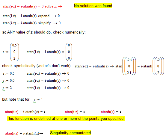

I guess not, since there are too many solutions:
so z=1 is an exception, and z=-1 is another. I guess those exceptions become obvious if you care to write the atan and the atanh in their exponential forms.

Jun 30, 2014 8:32 PM UTC
