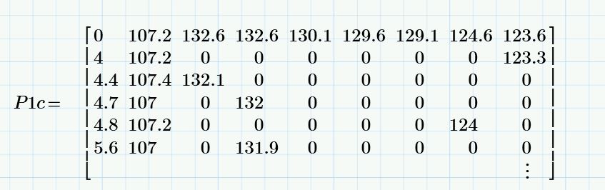

Data set looks like this about 350 rows

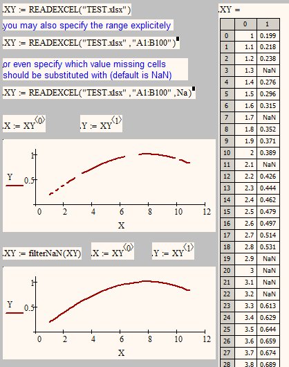

Is there any specific reason for using the Excel component?
I would rather use the READEXCEL function. Empty cells are replaced by NaN (Not-a-Number) by default or anything else you like. If used in a 2D NaN disconnects the graph. If this is not what you want, you can use the filterNaN() function to delete all rows in the matrix which contain at least one NaN.

If you are sure that 0 is no valid data you can follow Mike's idea and filter out all rows which contain a zero, but you will have to delete the same rows in column A as well to be able to produce a valid plot. You may use augment(A,datacolumn) and combine match() and trim() to do so.

It sure IS an option as those values will not be zero but NaN if he uses READEXCEL instead of the Excel component.
The real problem is that the component replaces emtpty cells by zero and we have no way to change that behaviour. Given the screenshot which was provided your appraoch can be an option as it seems that no valid data will be zero. Column A has to be treated the same so we probably get 7 different columns A for the abscisa.

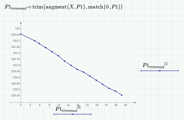

So if you follow my suggestion, I will follow yours and filter the zeros
I still don't like the Excel component but other than in Mathcad it seems to be the only possible way in Prime to embed the data in a convenient way to make the sheet self contained.
The attached should do the job, just do for the other columns what I did for P1.
@Mike: Something seems to be wrong with the data you used - the abscissa values seem to be wrong.
EDIT: No, your data is correct. The discrepancy is because Ron just exported the first 99 rows of his data.
