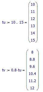

illegal context when range is multiplied
Hope you guys can help.
I can print out the range multiplied by some value:
Why can't I store the resulting range in the variable?

Add tu as a subscript to tv by typing tv[tu.
Because a range is an implicit loop, not an a array of values. Use a vector instead of a range.
Oct 24, 2014 10:13 AM UTC
Further to Werners suggestion, see below.
I have used an undocumented feature to turn tu from a range to a vector by in-line evaluation.

I am using subsript feature suggested by Mike Armstrong, but it still does not work:
LiL is still one thing that keeps formula from being computed.

Have a look in the attached worksheet. There is a user defined function called vec which accepts ranges, range variables and converts them into a vector. Use this instead of using ranges.
Remember you may have to explicitly vectorize using this method.
