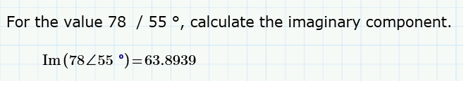

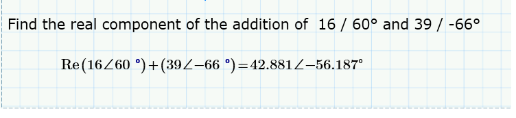

Hi
I am getting slightly different number not sure why
December 10, 2015
Aaron Garson wrote:
Hi
Different input -> different output.
Compare the numbers in your first post which I had used with the number you are using now!
78 is not 77
16 is not 15
39 is not 38
Furthermore in the last line you have wrong parantheses. You take the real part only of the first summand and add it to the second complex number. Put the whole sum in parentheses!
