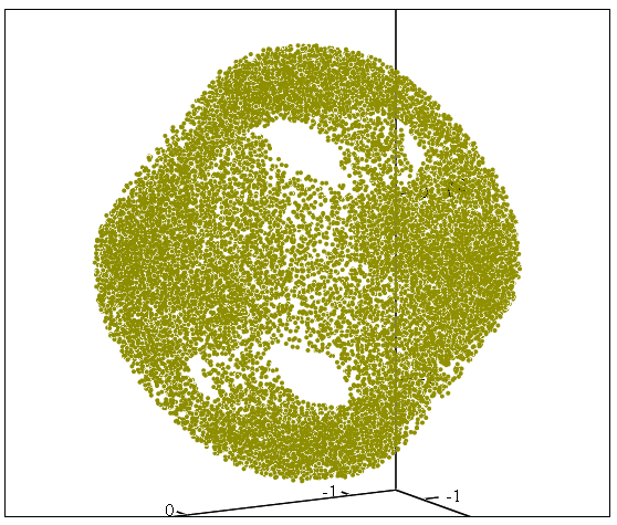

This is what it looks like (ff=0.075, bb=3) if you follow Valery's suggestion and use that kind of Monte Carlo procedure.

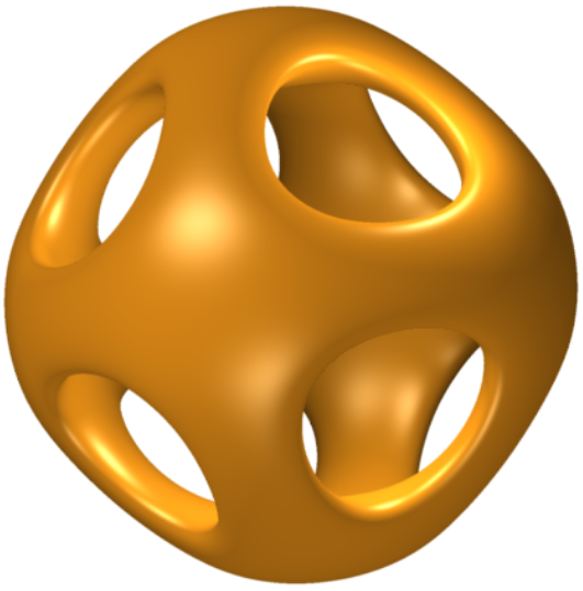

And this is what is should look like (done with PovRay by P. Burke (http://paulbourke.net/geometry/orthocircle/)

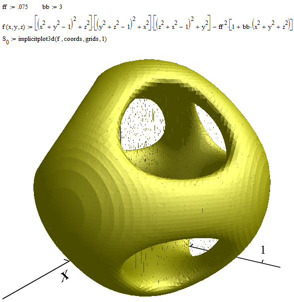

This is the result of Viacheslav's fine method for implicit plots.
Its not raytracig quality but quite good. Drawback is the calculation time. The picture was made with an 80x80x80 grid and took "endless".

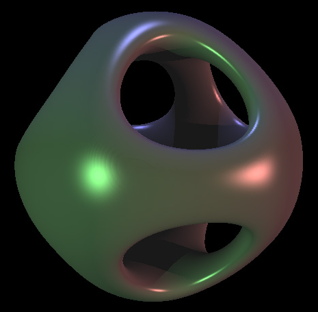

The following pic and the attached animation was done with the free software Surfer (link in post above):
