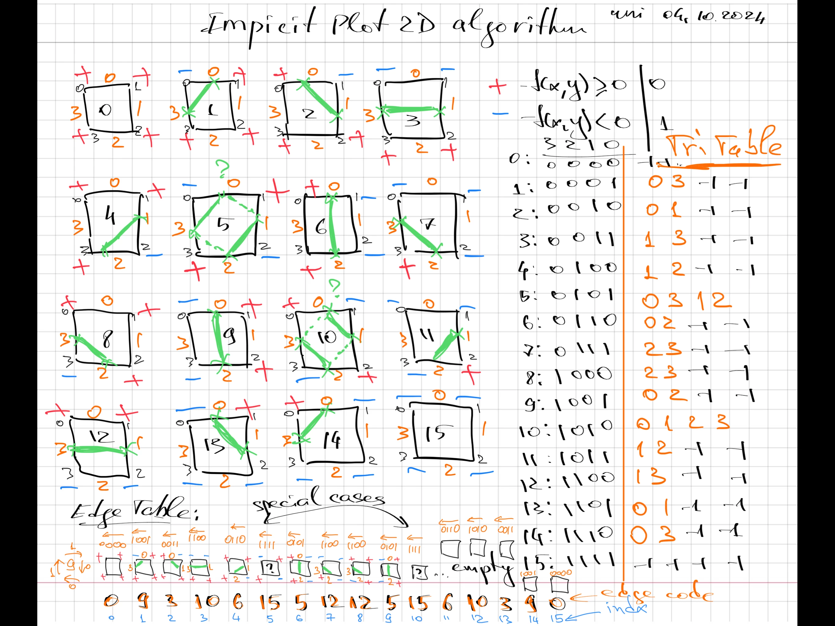

Does anyone know of some other documentation on the procedure used in this implementation? As one example unknown, there are two constant value arrays defined - EdgeTable and TriTable. It's not obvious to me how the values came about, or what properties of the procedure depend on these.

If I haven't got anything wrong, then this is where it all comes from.

When he posted implicitplot3D he gave a hint as to where the algorithm stems from (guess a similar one is used for 2D as well):
Idea: LORENSEN W. E., CLINE H. E.: Marching cubes: A high resolution 3D surface construction algorithm.
In SIGGRAPH 1987 (1987), pp. 163--169. 1.
Program author: (c) 2006-2007, All rights reserved, Uni Home Lab, Viacheslav N. Mezentsev.

Also found a pdf in Russian which seems to explain the algorithm used (main.pdf)

I did find that the algorithm takes each point (m,n) in the user-defined array of points and evaluate the function at the set of five points (m, n+1), (m+1, n+1), (m+1, n), (m,n), m+0.5, n+-.5). This is the box of adjacent points to the upper right of the selected point, plus the point in the center of that box. I suspect it's used to estimate the derivative, but haven't got that far as yet.

While I checked Uni's post as the solution (and the original source of the function), thanks also to Werner and Stuart for the info in their posts. All of these contributed to my understanding and background. I wanted to check all three posts as a joint effort, but that wasn't possible.
