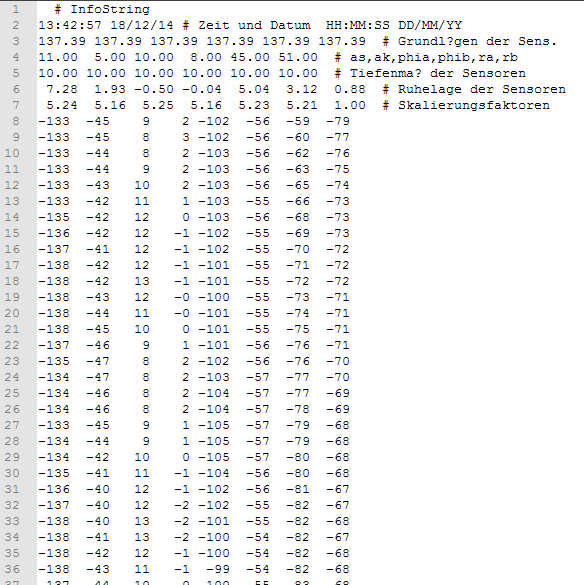

I am trying to import the data which has both the string and numbers from testing result in mathcad prime 3.0 version but in mathcad 15 version, I can sort the data with rows and columns as enclosed file but no idea to sort the columns as 15version did. someone help me? thanks in advance!

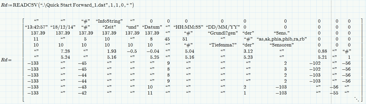

The file you try to read is NOT comma separated which means that the values are not separated by a "," sign.
You can tell Prime that it should use another separator (which seems to be simply a space here ore better: we have fixed widths) and also to replace empty values not by NaN's but by a zero (which seems to be the case in the picture of Mathcad 15 you provided).

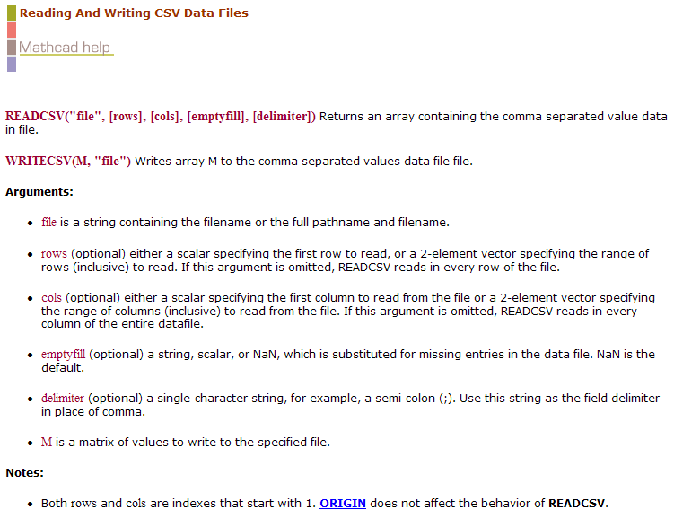

Unfortunately the Prime help, as so often, is not of any help here, so we have to resort to Mathcad 15 help

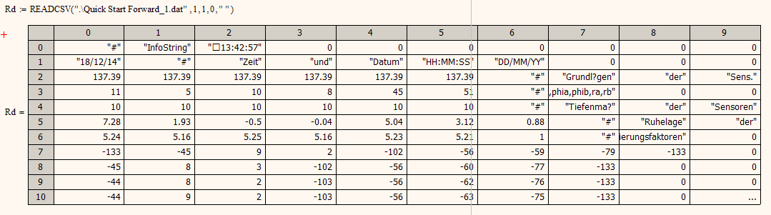

If we apply this information to your data we get
which seems to be close to what your Mathcad 15 pic is showing.

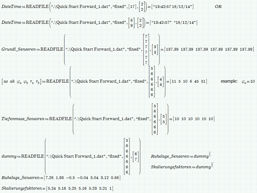

When I use the same command in Mathcad 15 I get this result
As you can see MC15s result is different but still not correct either.
You may consider reading the file beginning with line 8 (the actual data) and reading in the parameters of the first few lines in an extra step.

Only when If I look at your data file using a simple editor I see what the data actually should be:

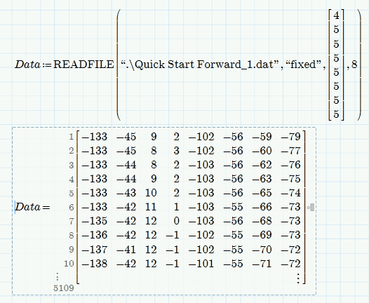

Here is a way to get the actual data beginning from row 8 in a neat way
There are 8 values per row and the data seems to be formatted taking up 5 columns (the first one only 4) per value (including preceding spaces). Therefore the 8 x 1 vector consisting of mostly 5's.
