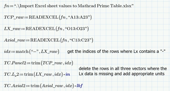

How about reading in each column via READEXCEL?
You have to be aware that the so called "tables" in Prime are meant for manual input of  data only, not for display of already existing data.
A Prime table actually just creates a collection of individual vectors.
In your Prime sheet you actually had defined 17 individual vectors.
Here as an example the creation of three of these 17 vectors using the data in the Excel sheet:

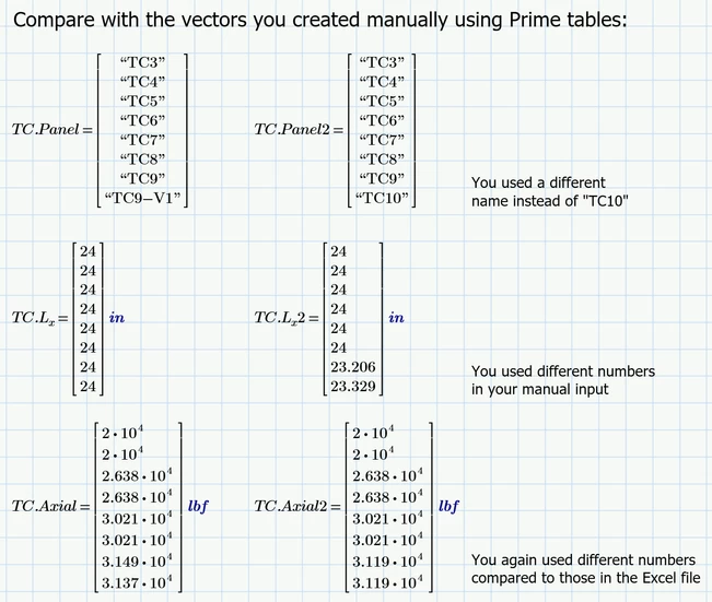

When we compare the vectors created that way with the ones you had manually input we see some discrepancies - in some places you did not use the exact Excel data in your manual input:

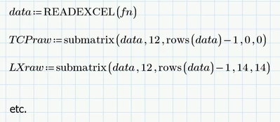

Guess it would also be possible to read in the whole sheet including the data you are not interested in an then use the thus created Prime matrix to extract the data needed.
Maybe something like

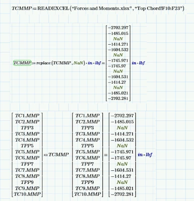

Last week, you and Stuart helped me with this reading each column via READEXCEL, as shown below. I just wanted to check if this process can be further automated.

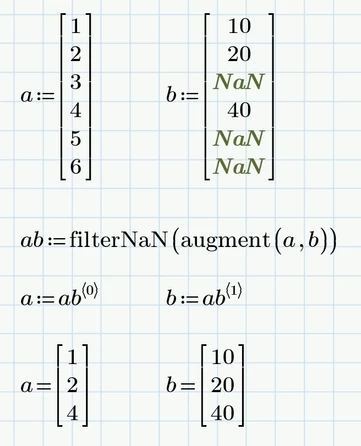

Sep 2, 2025 5:04 PM UTC
You may be able to use the "filterNaN" function to get rid of the rows containing an NaN.
But to get rid in, for example, in both of two vectors a and b of the lines where vector b contains a NaN, you have to first augment the vectors, then apply "filterNaN" and then separate the matrix again:
