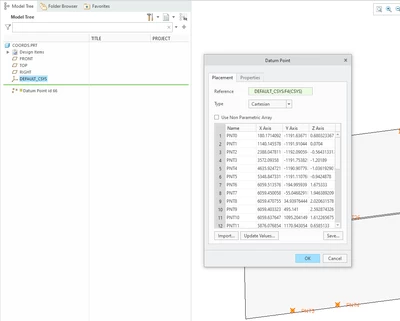

I have created a set of Datum Points in Creo. In my case there are 28 points, from P0 to P27. Those points have been imported from a .pts file.
Originally, there were 28 points from an xls file, which i copy pasted in a .txt file, I renamed that file to .pts and imported as shown in the screenshot.
So in Creo i got a single feature (Datum point id 66) that has all those datum points.

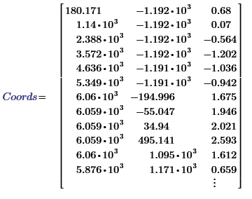

LucMeekesAnswer
23-Emerald V
May 29, 2023 9:09 PM UTC
Like this:
Then:
