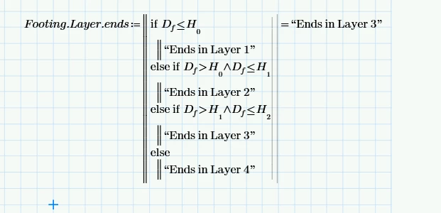

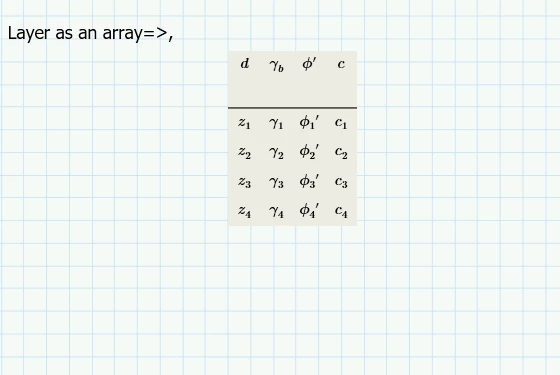

I have created a Mathcad sheet where I can find the capacity of a footing on a competent soil. The sheet is working but I would like to optimize at certain areas. My first improvement would be to see if instead of manually putting them as arrays, if it is possible to put in a condensed way so I do not have to type in the layer properties manually in case there are more than 10 or even 100 layers. My Second improvement will be if there is way to have a shortened code where “Footing Layer Ends” does the same output. Currently, it is for four layers but I would like to have it in a way that if there are multiple layers, it will handle the task instead of writing multiple if-else stateemnts.
Thank you in advance. My version is 10.0.1.0

You can read the data in from a file (e.g. text, csv or excel). You have to type it in sometime, unless you can calculate it from a known profile.
With:
and:
you could get:
