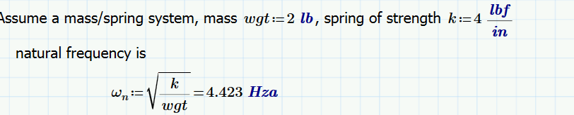

In case of linear vibration 'Time period' or 'Frequency' will be same for different displacement ?

For a basic oscillator, you are correct:

A "basic oscillator" has two requirements:
  1. The spring is a "perfect" spring--the spring force is proportional to deflection over the range of motion
  2. There is no damping.
From what (little) I've read about "functionally graded beams,"  it seems likely that one or both of these assumptions will not be valid.

The frequency and displacement of a vibration are independent. For a given frequency a larger displacement means a larger acceleration.
