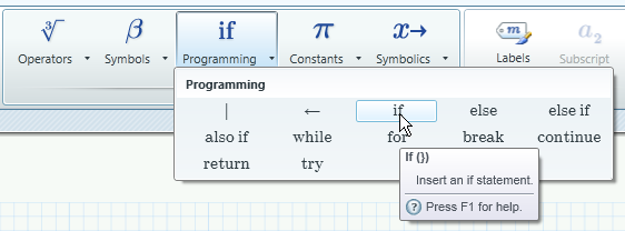

If you are not stuck to Express you can learn about those shortcuts at least by the balloon tooltip help when you mouseover a command
