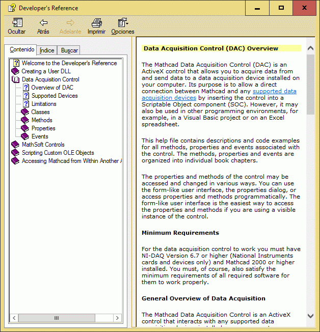

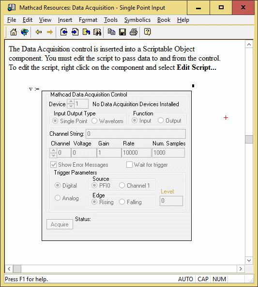

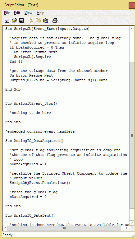

Hola Gustavo.
In Mathcad 11 you have a Data Acquisition scriptable object. In quicksheets, check under "Using Mathcad with other applications". There are four examples for this DAC. In the help, you see that it is a National Instrument interface between the physical hardware from NI and Mathcad. Atached two images from this.
So, what you need is a hardware device to capture the data and an OCX or DLL device driver which can be inserted as OLE object in Mathcad, and write your oun vbscript or java script to pass the data into mathcad.
Attached some images of that.
