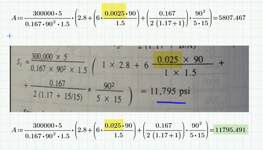

I am trying to solve a equation as provided in handbook but no matter if i use units or not I am not getting the correct result. I tried with applying units but somehow it gives me wrong solution

I attach your file here but I guess I found the error - you were too generous with the zeros 😉
