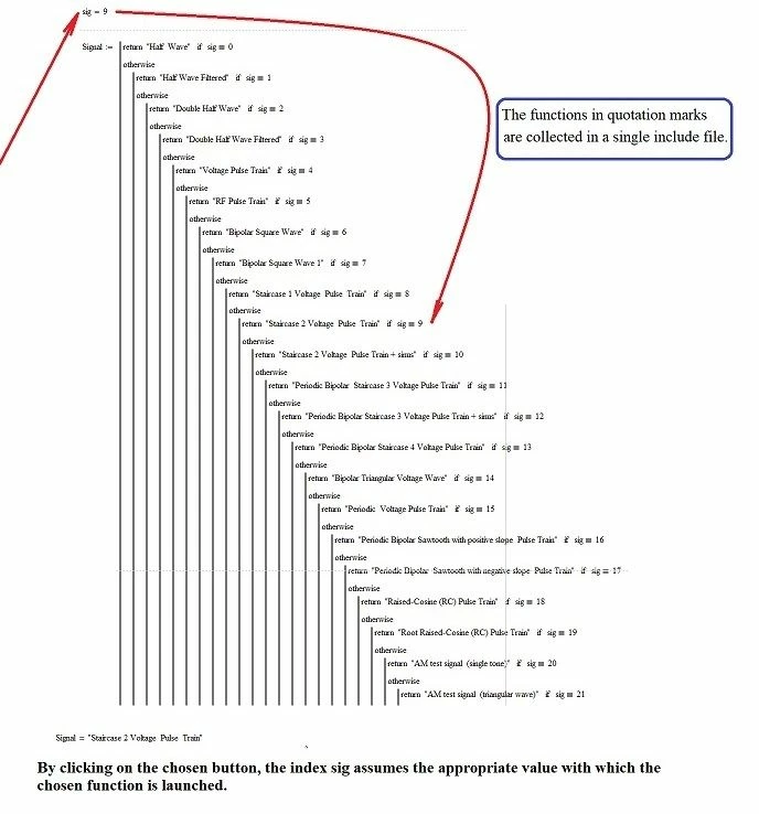

You could do as shown in the following image:answer to AE_10050416.jpg

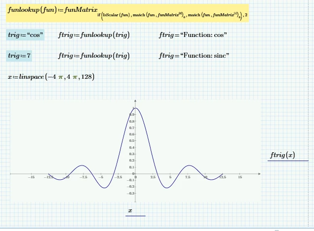

October 1, 2021

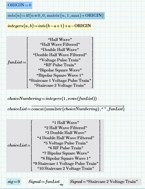

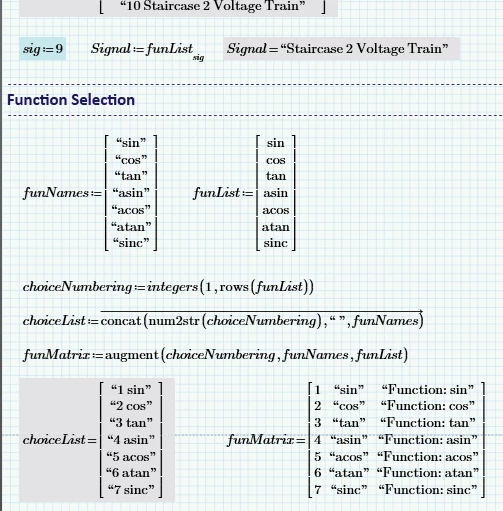

What was the reason you chose the nested if-otherwise structure instead of, say, a vector?
Or,
Stuart

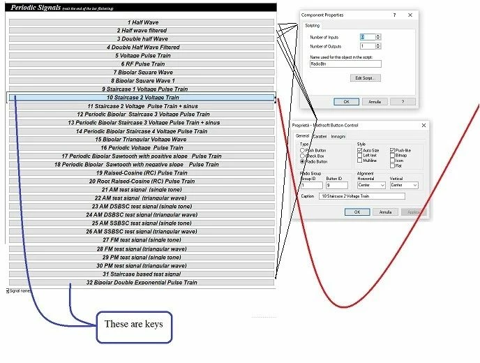

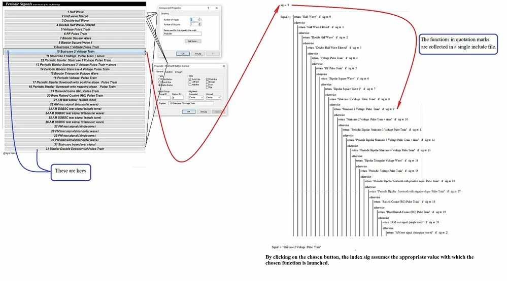

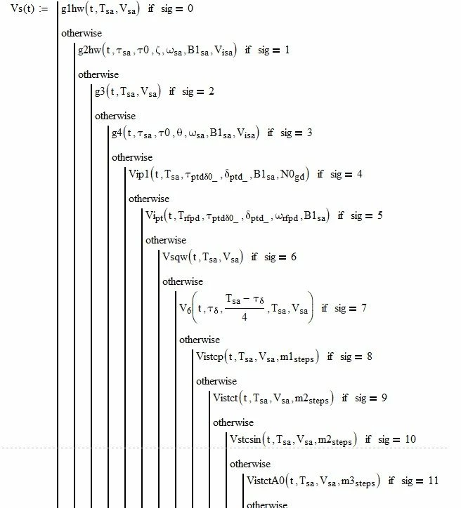

October 1, 2021
I made it in 2018 and I published it in this community some time ago. So I thought that a click was enough, in your file, however, "there is no click". In my worksheet, there is still another if-otherwise nested structure for the actual launch of the chosen function by clicking on the corresponding button. I like your solution, it simplifies many things, however, I think you will find problems with the launch of functions that present, in addition to the independent variable, also parameters in number varying from function to function. See the following image:
