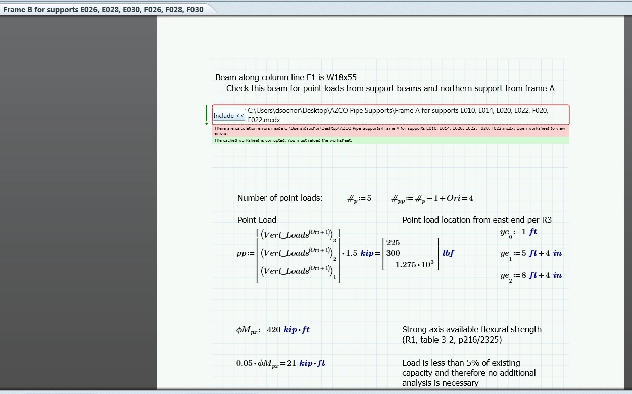

To simplify a project where multiple steel frames are being designed I've incorporated the use of "include worksheet" in MathCAD prime 3.1
All the worksheets include a worksheet that has basic quantities calculated, like a parent - multiple child relationship. I've now tried to have one of the child worksheets include another child worksheet and I get the errors in the attached image. Reloading the worksheet has eliminated the green error but the red error persists. The included worksheet has no errors. Are there any limitations to including worksheets that would not allow this include to work?
dsochorAnswer
May 15, 2017
Although the included worksheet is highlighted in red, it still allows variables to be called. this is not longer an issue
dsochor1-VisitorAuthorAnswer
May 15, 2017
23-Emerald V
May 15, 2017
"Are there any limitations to including worksheets that would not allow this include to work?"
There shouldn't be. But then, there are lots of things that "shouldn't be" with Prime, and maybe even more things that "should be, but aren't".
Anyway, I can't check, since including references is a "premium feature",  so not available to the Express user...
I can only suggest to set up a simple structure with few definitions as in something like:
Sheet 0 contains Asub:=1.1
Sheet 1 contains Reference to Sheet 0, and following that Bsub:=2*Asub
Sheet 2 contains Reference to Sheet1, and following that Csub:=3*Asub
Sheet 0, 1 and 2 should all work without problems.
I guess you could run into trouble when you try to include Sheet 2 as a reference into Sheet 0...
