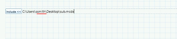

Can I pass string variable into the include statement to based on file path as a string variable? Can it be done

Thanks for your response I have an understanding of CWD command.  I’m looking for a way to pass a string variable into the include statement to include a MathCad file based off of the file path stored as a string variable. Is there a way to do this?
Is there a way to make ssmith as a variable  that is in include path?
If you (or your local neighbourhood tame programmer) are up for some programming in a different language in a different environment, then you could see if the Mathcad API would support you in writing a function that inserts a reference.
I've had a quick scan of the API but couldn't see anything, but that's not to say it's not there (I haven't written a Mathcad interface in over a decade).   If you're a support customer, then it might be worth asking the question of PTC.

Hate to be the bearer of bad news.
The answer is no, but it would be a great feature to ask for.
