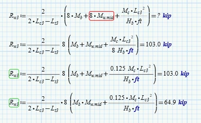

I can't figure out why the first equation in the picture does not work, Mathcad says "These units are not compatible." The units of M.w.mid are kip*ft, and 8 is dimensionless. There are no matrices in this spreadsheet, but for some reason the dot/multiplication symbol is acting weird, or like a dot product. I don't really want to use either of the middle equations, because they don't match AASHTO, but if I have to I will. For reference, the correct answer is 103.0kip. Mathcad 15 also returns 103.0kip without a dimension error.
Best answer by MP_10109706
M.b =0
Mw.min = 36.84 kip*ft

Mb=?   Mw.min=?
MP_101097061-VisitorAuthorAnswer
November 29, 2022
M.b =0
November 29, 2022
And after second formula?
Send please Mathcad-sheet! Prime 7 better!
