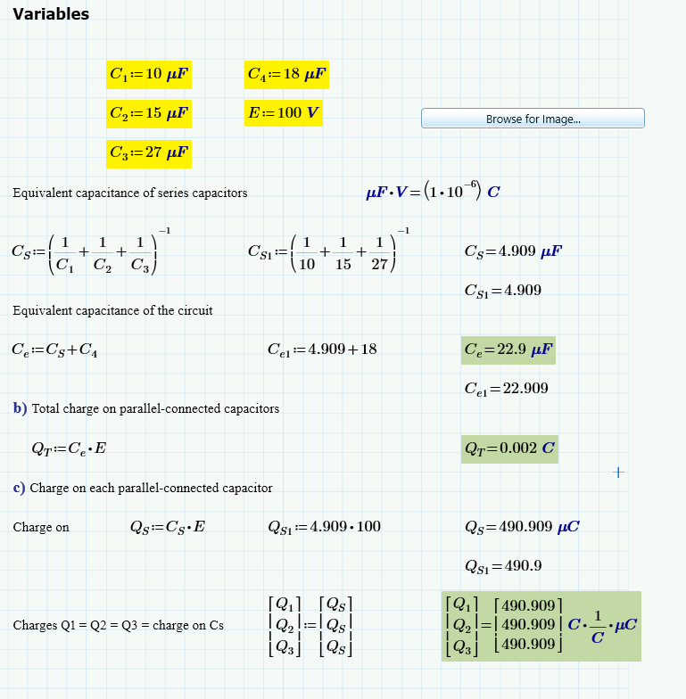

Hi
Not sure why I am get the incorrect units and the problem cascades down work sheet to produce incompatible units.
Thanks in advance.

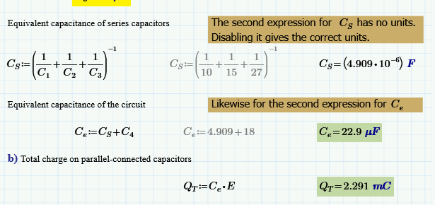

How about this
Mike

Unfortunately I can't read your file as my Prime 3 can't open files in 3.1 format.
But you were already told that the second assignment, where you did not use any units, was the reason for your problem.
I guess this assignment was done for documentation reasons and you might consider using the symbolic evaluation with the keyword "explicit" instead.

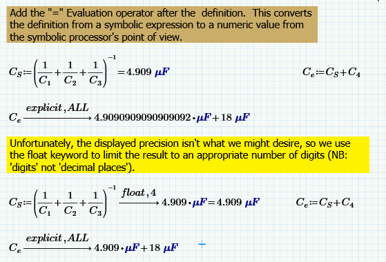

I have redone the first assignment in Mathcad 15 but it should work the same in Prime:
In Mathcad we also have the option to hide the keywords and to change the arrow for an equal sign, so it looks like this
Unfortunately these options are not available in Prime, being just a subset of Mathcad15.
You can also use the assignment directly followed by the symbolic evaluation with explicit in one line.
Again, the second display is not available in Prime (you could also let the := being displayed as a normal 😃
Also bear in mind, that "explicit" works fine in this example, but its use is limited and it may not always give you the display you have in mind.
But all the other alternatives, like writing the expression a second time using the boolean equal sign just for documentation or disabling the second assignment have the huge drawback, that the documentation doesn't really show the actual calculation. You could change the value of C.1 and if you don't update your doc, its showing the wrong values.
Werner

Thank for the tip on explicit notation I full understand where you are coming from and did fully understand this function. Is it possible to only have part of the equation in
explicit, see example below.
