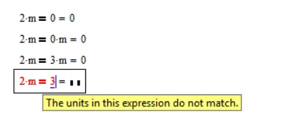

Can anybody explain me this (see screenshot)?
After the "=" in the matrix I see what are the right units (which are no units for the last 2 elements).
But when I try to use them later, it looks as if the last 2 elements are in m.
I attached also the mathcad file. I use Mathcad prime 3.1

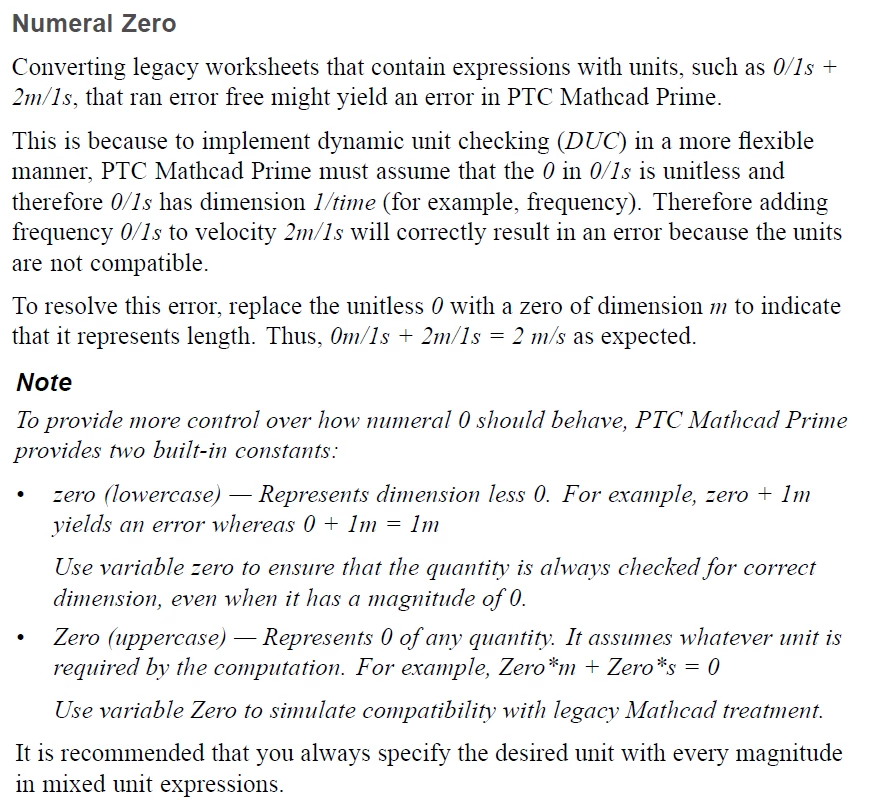

Thats where zero and Zero come to play:
Its explained in more detail in the Prime Migration Guide (see attached)

That's because Mathcad (and apparently Prime too), will append units to a value of 0 whenever it is convenient (to the discretion of internal algorithms).
You can check equality between 2 m and 0 m, as well as between 2 m and 0, and they both result in False (not True). but an equality check between 2m and 3 throws an error.
I guess something similar is going on here.
