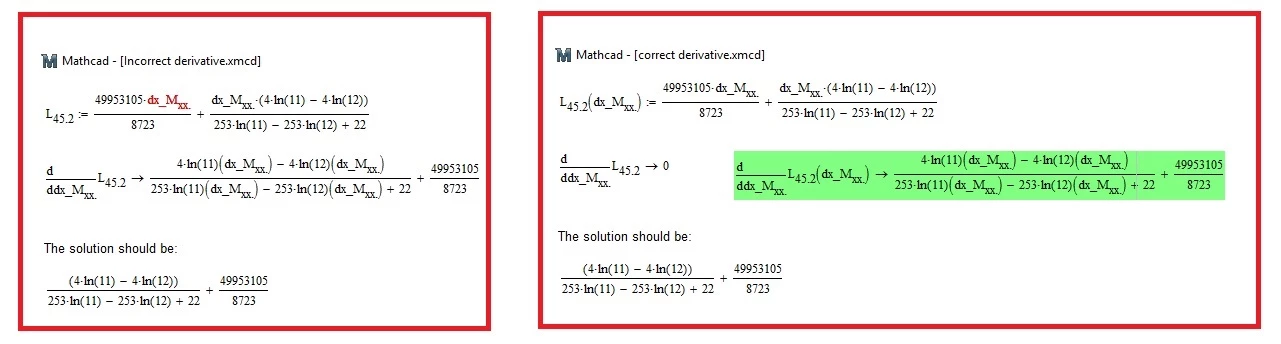

I encountered a very strange problem in Mathcad 15. When I want to calculate a derivative symbolically that contains a natural logarithm the solution is wrong. I do not know why is it so.
Attached you can find the Mathcad file.

Works if you get the syntax right
Hmm. It still does not work for me. Maybe it is related to Mathcad 15 version/patch? I attached a snapshot of my original problem (left) and your solution (right).
Seems like a bug to me.  You get the correct result if you put variables in the natural logarithm instead of numbers:
Yes, it is a bug. The problem does not appear in Mathcad version 13.

The bug is there in the earliest M15.
If you click on the ln(2)(x)  the display changes to ln(2(x))
Alan
Alan
Oh, I see. Its a strange bug. And when we assign the derivative to a function and evaluate it symbolically, we get a strange error message
