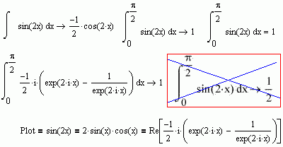

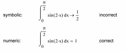

incorrect symbolic definite integral of sine
  • May 12, 2010
  • 5 replies
  • 5153 views
Is this a known bug in MC14.0 M20?

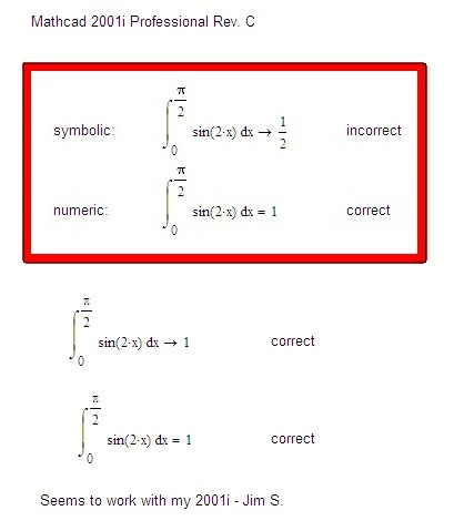

May 12, 2010
Both symbolic and numeric work in my MC2001i rev.C

May 12, 2010
My version of MathCad 14 (14.0.0.163, build 701291152) does not have this bug- both methods evaluate the integral to unity.

May 12, 2010
I don't recall seeing that one before. It's broken in M030 as well.

May 13, 2010
>M20?
It is now!
I get the same problem - running Mathcad 14 M020 (14.0.2.5 [802141434])
