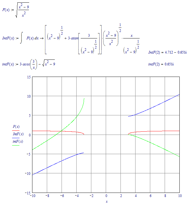

Hello community, I'm new to Mathcad so I need your help
I try to calculate indefinite integral but it doesn't work, maybe I'm doing this wrong way?

Sometime Mathcad is a bit touchy and you have to be more precise:
As you can see the results differs in sign depending on which part you'd like to integrate.
And sometime it sufficient to tell Mathcad that a variable is real only:

Hmmm. Mathcad 11 gives this:
and simplification...:
The same.

Further exploration:
Quite a different result between Mupad and Maple!
