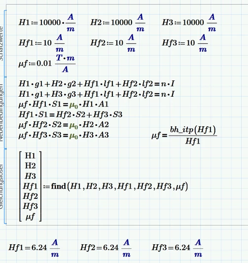

Hi, I've been trying to use some solve blocks inside a program. The solve blocks return matrixes with the solutions of the equations. I'm trying to get these results inside a program, but the error "indexed assignment to a matrix element is not permitted in a solve block mathcad" keeps showing. I don't really understand what it means. I've attached the file.
Edit: I haven't put any solve block inside the program, but instead tried to get outputs from outside solve blocks.
Werner_EAnswer
The reason for the error message you get is, that you have erratically used a vector index for H1_2 in the Hi-gap solve block when assigning the guess value.
After you change that for a literal index the error is gone away, but you get a new unit mismatch error when calling Hi_iron.
Can it be that you forgot a factor S3 on the left side of the third equation?

You cannot (in Mathcad or Prime) put a solve block into a program, but you can make the output of a solve block a function which you can use further.

Check your labels. The 'Hf' solve block (2nd iteration) tries to find 'Hf1[1' which is labelled as a constant (green) instead of variable (black).

I think that one single solve block can replace all the others and this loop a well:

That's impressive! How does Mathcad gets Hf_1 to calculate Mu_f? I thought the only way I could solve this problem was through repetitions, as I had done. Does Mathcad "know" it is needed to make a iterative process and do it by itself? Thanks for the help.
