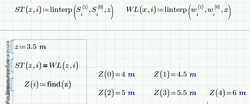

I am using MC Prime 3. I am trying to see if it is possible to interpret various points using indexes as per the attached.
Basically I have defined various matrixes and interpreted lines between them as a function of z. Then I have used solve blocks to find the z value when the two lines interpreted from my matrixes meet. However, as I am doing many iterations of the same thing I want to know if it is possible using indexes or if there is a better approach? I have never got into MC Programming but guess that might be an approach?

See if the attached file helps!

Hi Valery,
That is really interesting! I think that solves my initial problem. as outline. Could you take this a step further. Where I want to interpolate ST with the WL values but I have multiple sets of WL as the attached.

In Prime 4 all ok. In Prime 3.1 I have your error.
