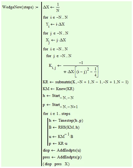

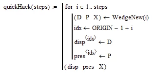

A quick hack would be to use my "WedgeNew" function in a loop and collect the results column-wise in a matrix:

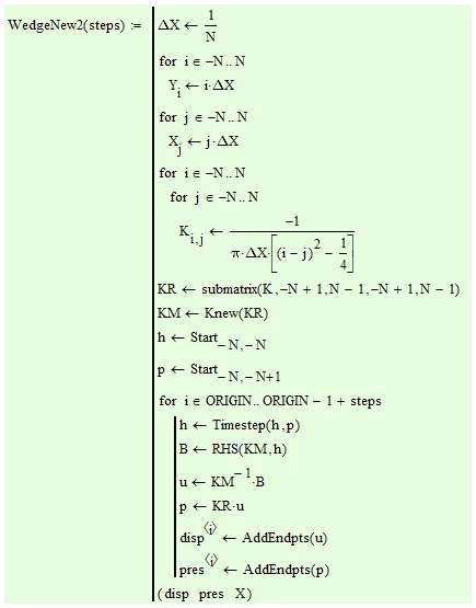

But its more efficient to rewrite the WedgeNew function to do the job right away:

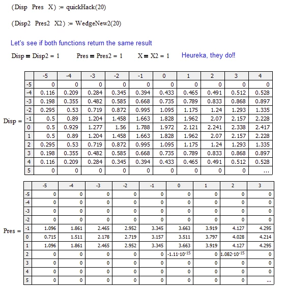

So when you demand for 20 steps, the results of "disp" and "pres" would be a 11 x 20 matrix each.
Mathcad 15 sheet attached

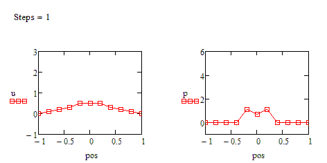

It looks to me that you are only interested in the results of the last iteration step, right?
So it would not be necessary to store all the intermediate results in a matrix.
Here is what I came up with - hope it helps.
Not sure if the animation makes much sense
Worksheet and avi attached
EDIT: I just noted that you sure can delete this loop
in the various "Wedge" functions as is has no effect. Y is never used later and Y would be identical to X anyway.
While I am at it - you can replace the nested loops
used to create matrix K by using the matrix command
But when I now compare the two, I guess the second isn't much easier or shorter and the nested loops may show clearer which calculation is applied, 😉
