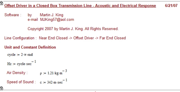

Mathcad explorer 8 will install on (my) Windows 10 64 bit PC, but silently abort after starting to run.
I guess on 32-bit systems it will install AND run.
Two of your files are newer that Mathcad 8 (TL_... and TQWT...) and will probably not load in Mathcad explorer 8.

I tried opening and converting the first file in Mathcad Prime 8.  It says there are collapsed and locked areas.  It looks like it would need to be opened in an earlier version (Mathcad 15).  Then open and unlock any of the collapsed areas.  This assumes that you have passwords to unlock any locked areas.
Actually the region is not collapsed but just password protected to avoid anybody tampering with the data
BTW, a true converter would ask for the password and would then convert the sheet. Even better it would recreate the locked area und relock it using the same password using the Prime method. As far as I know it is possible to retrieve the password from the Mathcad file somehow and so it seems that there is not just a hatch but the full password saved in the file. So PTC should know how to retrieve it.
The way it is now, the user is told to use a software which is not for sale, not available anymore to unlock the areas. That is out of the question and unacceptable.
It would be nice if the converted at least would convert the sheet partially, leaving out the protected area. So the OP could easily retype the few definitions (which he is able to see in using Mathcad Explorer). But unfortunately Prime refuses to convert anything and so the OP would have to retype the whole sheet - given that he would be willing to use Prime.
The other option is to contact the author Mr. King and ask for the password to be revealed and then asking some kind soul here who is still in possess of a real Mathcad to unprotect the area. It should not be necessary to have to become a double supplicant!
