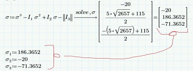

buenos días.
como puedo extraer los valores automáticamente,
LucMeekesAnswer
March 1, 2021
What do you mean 'without transcribing'? Where did I transcribe?
Or do you need this:
March 1, 2021
You already have them automatically.
Apparently your problem is this:
Because you assigned the result of the solve to sigma, the solution is in the vector sigma. Do not assign (  :=  ), but evaluate ( = ) :
Oh, you want them in reverse order? Do this:
March 1, 2021
Another approach is to define a function sigma with I as parameter, to give you all possible solutions of this equation:
Which is big!
Now:
and

March 1, 2021
quisiera conectar sigma 1, sigma 2, sigma 3 de forma directa sin tener que trascribir. lo mismo quisiera con un bloque de resolución en el que pueda extraer los resultados para realizar comprobaciones.
alguna ayuda sobre el tema?
