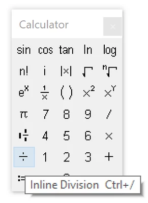

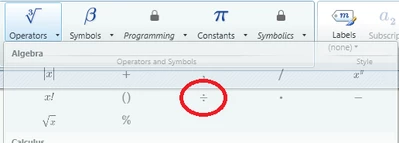

Inline division character
Hello!
Is there a way to change the inline division sign from this "÷" to that "/" ?
I saw arguments about the slash sign can be misread to 1, but as is the division sign can be misread to +.
It would be great to be able to change the operator styles as we please.
Or can I find the files where the operator characters are stored, so I could override them manually?
P.m. Im using Prime version. The goal is to be able to see the following: x/y, and not x÷y.

May 10, 2022 8:21 AM UTC
What is 'not in Prime'?
There's no shortcut for it, and there's no infix notation, but the inline division is there.
And in Mathcad (1 through 15) you cannot change the symbol for the inline division, it has to be ÷.
