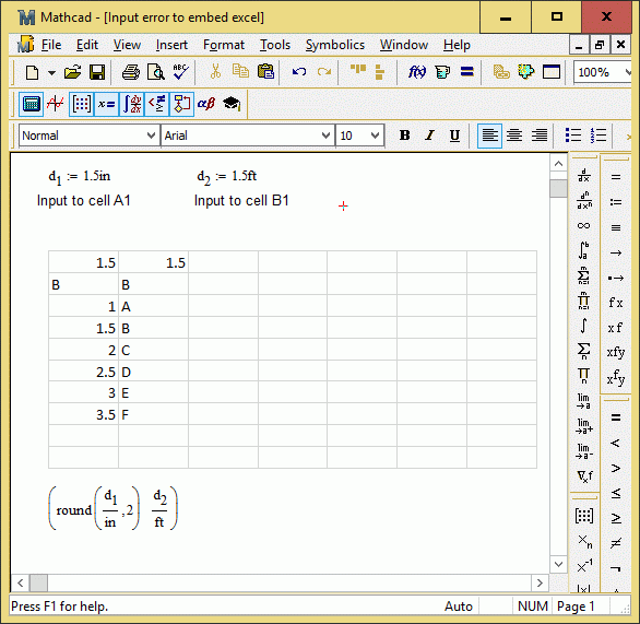

Hi Neptali.
Use round before send, like the figure, or after, in excel.
Best regards.
Alvaro.

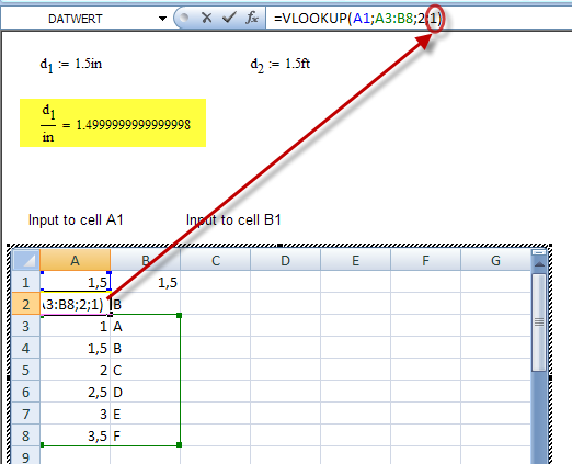

September 8, 2016
You experience roundoff errors
And this value can't be found by VLOOKUP in the first column of the excel sheet and because the last parameter of VLOOKUP is 0 (=FALSE), Excel looks for an exact match the therefore throws the error.
One way to deal with is, as Alvaro suggested, to round off the value to an appropriate number of decimals - either in Mathcad or Excel.
Another approach, which I would prefer, is, to modify the last argument of the VLOOKUP command in the EXCEL cell and change it from 0 (FALSE) to 1 (TRUE) or delete that argument alltogether, as TRUE is the default value anyway. The values in the data range have to be sorted in ascendant order for this to work.
