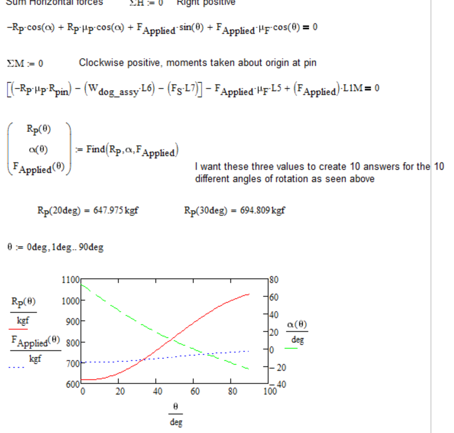

I have three equations which I want to solve. The equations are made up of variables which change according to a specific angle which updates them.  I want to get the results as a vector which shows how they change according the angle which is changing the input values. Basically I want to input 10 values and get 10 answers out. But the "find" command that I am using just isnt accepting it. It only accepts one input and gives me the output, I must then go change the input to get the next output; but I want a nice set of vectors to do this in one step.
Im not sure if I explained that the best but if anyone could tell me if the find command is capable of such a thing or if theres another way to get around it..
such as a loop or something.
Any help would be greatly appreciated, thanyou!

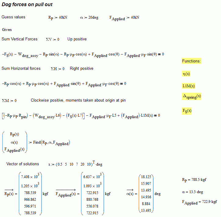

Hi. Valery solution is OK, but he does it for theta, not for x.
Because x isn't explicit in the solve block, must to introduce it, making all dependences of x as functions, like in the attached.
Best regards.
Alvaro.

You can create a function based on Find function.
Given
y(x):=Find...

Please find attached a copy of my mathcad, sheet. Thankyou for responding so soon.
thanks again,
cameron
Best regards.
Alvaro.

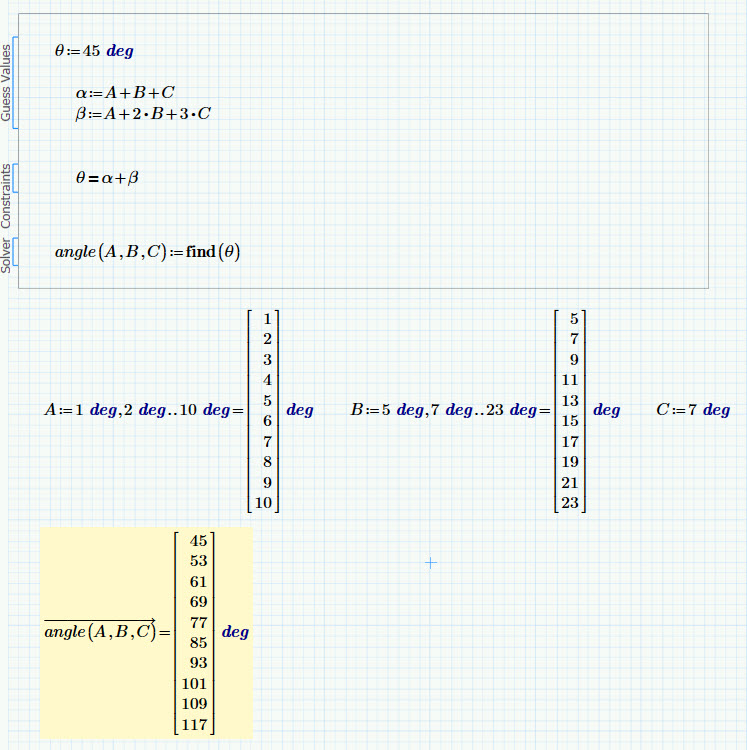

I think the attachment might be something like you are trying to accomplish.  It takes multiple inputs and calls the solve block as a function.  Note the Vectorization of the call.  Obviously it's just made up equations to demonstrate the concept.
(file in P3.1 but pdf included)

July 8, 2016
Guess i was too slow and was playing around with the sheet you posted here ->
https://community.ptc.com/t5/PTC-Mathcad/Mandrel-Pull-Out1-xmcd/td-p/446438#comment-26237
So I didn't realiized that the problem was already solved by Alvaro.
Nevertheless, for whatever it may be worth, here is my sheet.
I added a small table at the end
Regards
Werner
