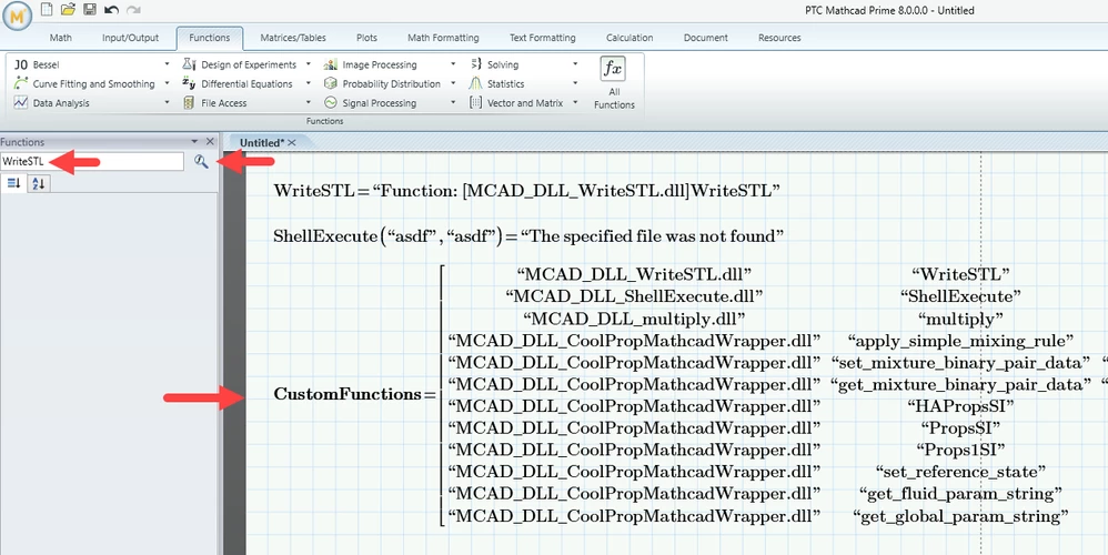

Good morning,
I am starting to compile more custom functions. I thought it was possible to have these appear in the "insert function" action. However, these do not show up.  I did stumble on CustomFunctions =  to show the content.
Is this possible?
23-Emerald V
Jul 22, 2022 2:19 PM UTC
I don't think Prime supports this; that is, I can't find it in the description anywhere.
