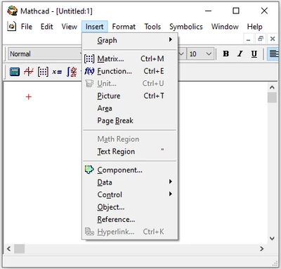

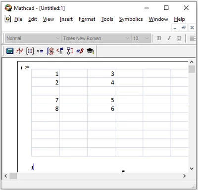

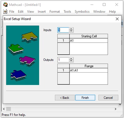

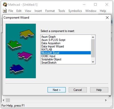

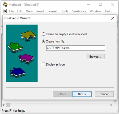

23-Emerald V
Apr 23, 2024 5:18 PM UTC
Hi Raiko,
(real) Mathcad, or Prime?
Excel file:
Mathcad:
