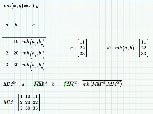

I guess the requested functionality is not implemented. I was able to create following notation.
Please read https://community.ptc.com/t5/Mathcad/Table-Basics/td-p/321822 discussion.
