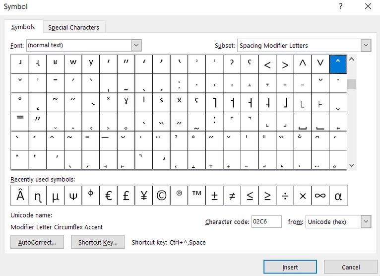

Best answer by ValeryOchkov
I search and paste some letter in Word than copy in Mathcad

It is a good idea, but I was interested in whether you can insert that special character (for example the hat, but also other characters) directly from a Mathcad tab.
But as an idea, if there is no other variant or other idea / illuminating solution from any other user, it is a very good solution to try when I need to insert various special characters and which are not found directly in Mathcad.

I assume you are using real Mathcad (MC15 or below).
You can't edit or extend the characters available on the greek palette or any other
You may try to copy characters from other software, maybe additionally using the Ctrl-K "trick" when creating a variable name. On program you might find very useful for doing so is the system program "charmap".
I could not find the p with the hat there (and obviously Valery wasn't able to do so either). So when it comes to create new letters using diacritic characters it may get more complicated.
There were some old threads here in the forum that explained how to do it, but on my system with a different language setting I was never able to duplicate the effects shown in those threads.

I use Mathcad 15.
Letter p was just an example (it could be another letter or even a number, does not matter).
The question and point were that: it is possible to add, for example, to a letter a hat (but also another character, like in word?
