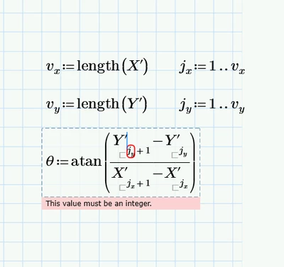

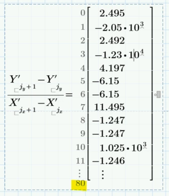

And I do not know why there are that many elements in the calculation, as we have only 10 elements in X' and Y'
11 replies
ttokoro
Apr 19, 2024 6:01 AM UTC
Your jx and jy are range. So you must select one of it by [0 or ^row(0).

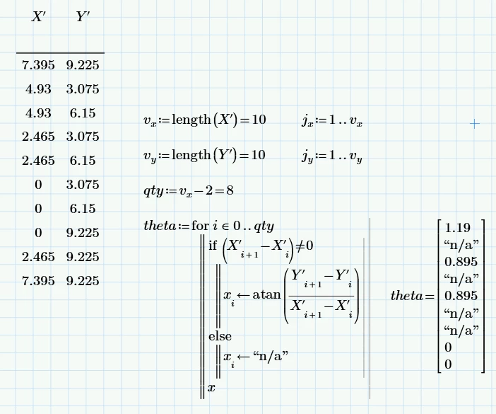

I'm not sure if I understand what you are trying to say , Can you show me in the attached sheet
I want to apply the atan function to all x and y values
