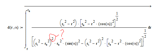

We are working with a tyre manufacturer. They are using excel for engineering calculation.
The calculation is an integral calculation where they have 2 variables "alpha" and "r".
We have to solve this integral calculation and have to plot 2D and 3D graphs. The graph throws the profile of tyre and they use that profile for mold making.
I build some calculation in Mathcad but kindly suggest me a best practise.
I attach Mathcad and excel sheets herewith.
Dhinesh

Well, firstly you could import the require data from Excel as I shown you in the other thread.
Mike
Jun 25, 2011 12:01 PM UTC
You made ​​a mistake somewhere in the recording of the integral.
It is possible here:
Vyacheslav.

Jun 28, 2011 8:14 AM UTC
Vyacheslav,
Good catch.
I'll check the equation and i'll hit back.
