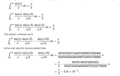

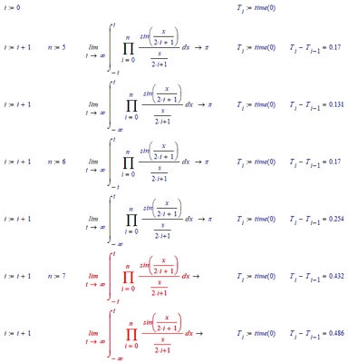

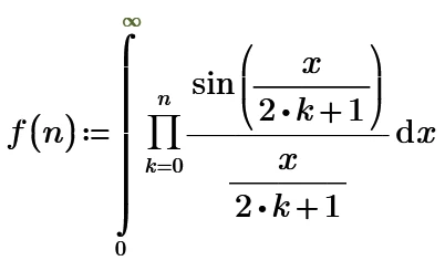

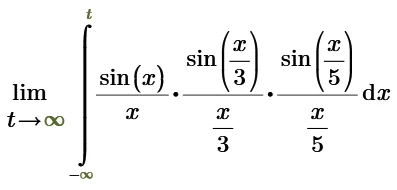

Integral sinc(x)
Quora shows interesting math. Prime 7 can show third equation is also pi.
I want to calculate until
and
ttokoro_1-1633168484513.png does not show pi/2
image.pngimage.pngimage.png need very long time to solve.

Borwein integral - Wikipedia
Quora is true.

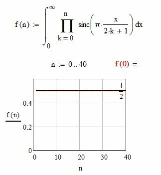

Please note that the definition of Mathcad's sinc function differs from that used elsewhere. The Mathcad definition is sinc(x) = sin(x)/x, while on certain texts it is defined like this: sinc(x) = sin(πx) / (πx) so in the comparison of the calculated values and those of the text there may be differences. I'm referring to Mathcad 15. Certain errors in MC15 have been fixed in Prime 7.

This is limit of Prime 7.
Therefore, I can't get the results shown by Quora web site.

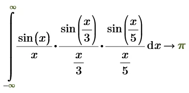

October 6, 2021

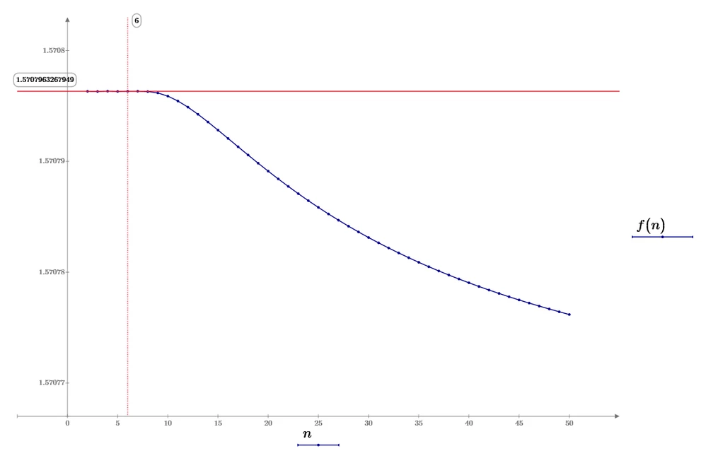

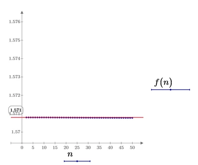

October 6, 2021

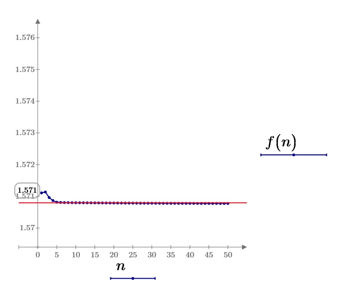

image.pngimage.png TOL=10^-3
ttokoro_0-1633562726618.pngTOL=10^-7
Therefore, Quora and Luc show the answer is pi/2 for n=0 to 6. But n>6 are not calculate symbolically when using 15 digit accuracy. May be n>6 also show pi/2 symbolically when calculate more digit accuracy. Or Quora is true mathematically.

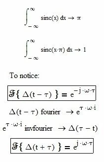

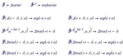

I use the sinc function according to the definition of the text reported here below. Sin (x) / x is something else ...
