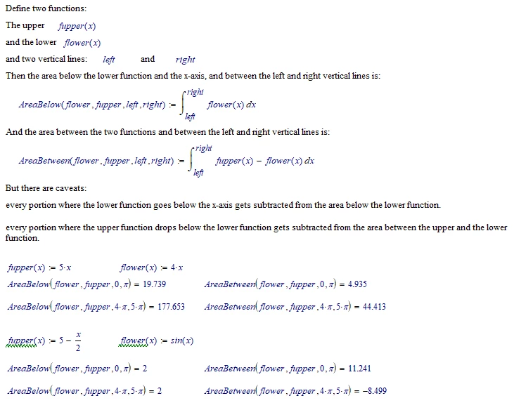

So firstly sorry I’m not at home so don’t have an example to show but what I’m after is integrating an area and performing multiple tasks between two limiting functions.
I.e I have a function which I’m going to integrate underneath. this function is in terms of x. (A line that increases up the y axis as x increases)
Then I want to introduce two functions in terms of y ie vertical lines.
I then want to integrate the area under the first line and between the second two. Any idea how I do this? FYI I use prime 3

Best answer by Fred_Kohlhepp
Try this:

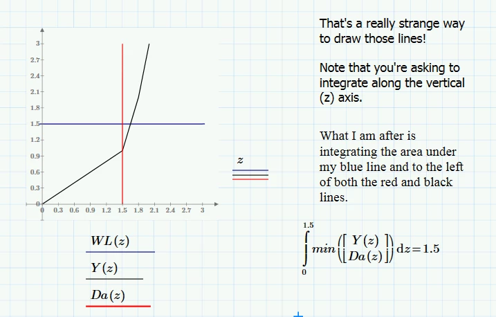

awibroe1-VisitorAuthor
November 27, 2017
Hi Luc,
Thanks for that. Yes, in a way I think that gets me to where I want to be.

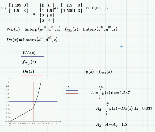

Now I am back at work, see attached image of the sort of thing I am looking at. What I am after is integrating the area under my blue line and to the left of both the red and black lines. I have experimente with a few ways of doing this and as you say can do this by taking areas away from eachother. Obviously for now I am working with simple shapes but this could get quite messy when I apply the logic to my final objective which is much more complex.
Cheers,
A
23-Emerald I
November 27, 2017
Try this:
