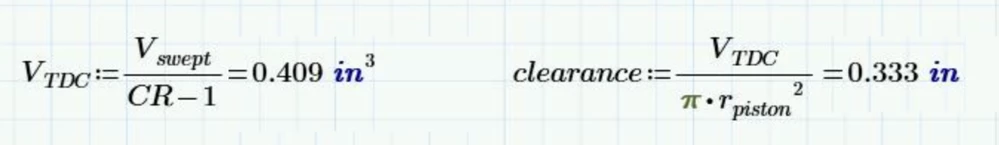

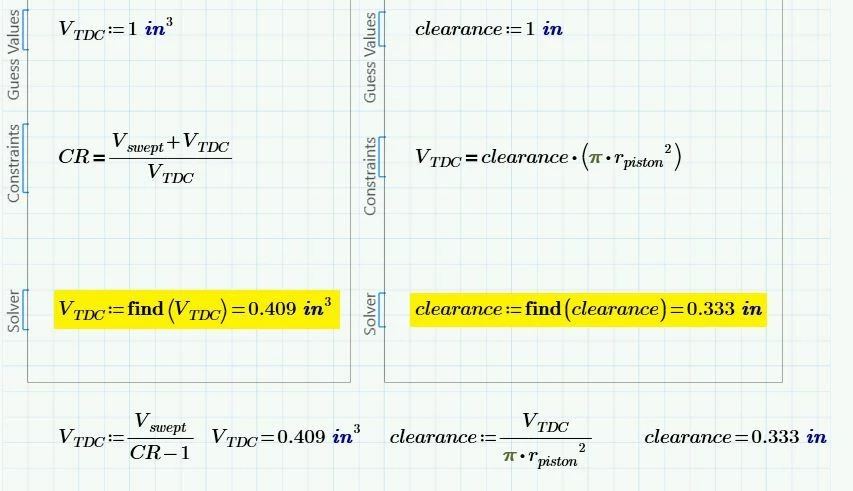

October 4, 2017
You can eliminate the two Solve blocks with direct calculation if you want to streamline the sheet.

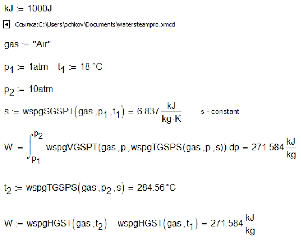

October 3, 2017
Use please
www.wsp.ru
for same calculation/
One example for Mathcad 15. Works with Prime 4 too
